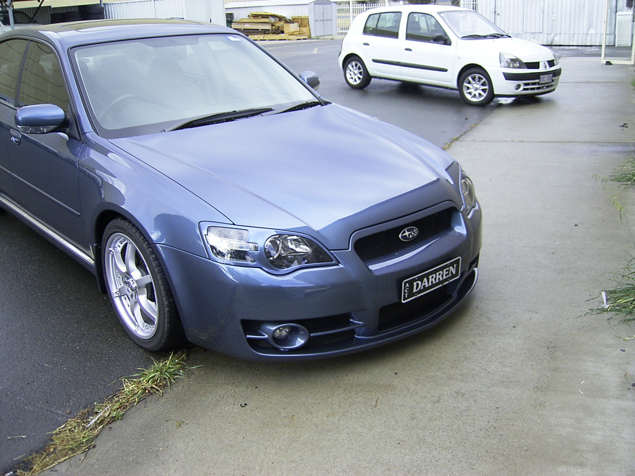

I still have my Liberty and it has a zorst. I got it from Hitech. Fantastic note especially in the upper ranges.
Cheers
Darren
